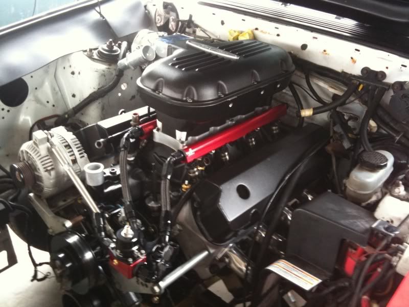

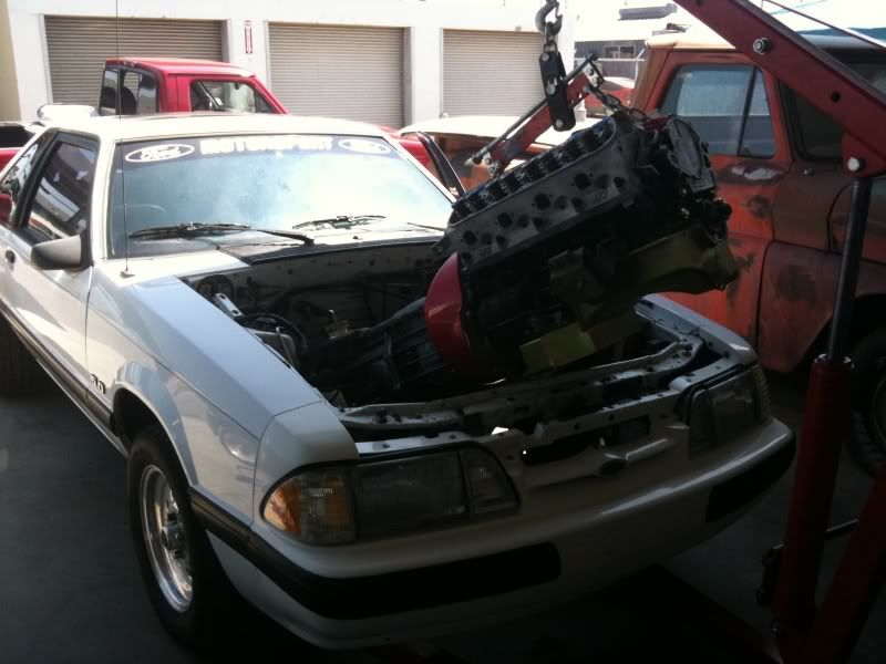

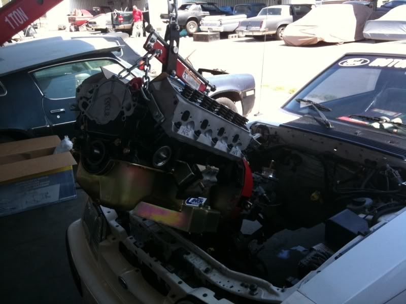

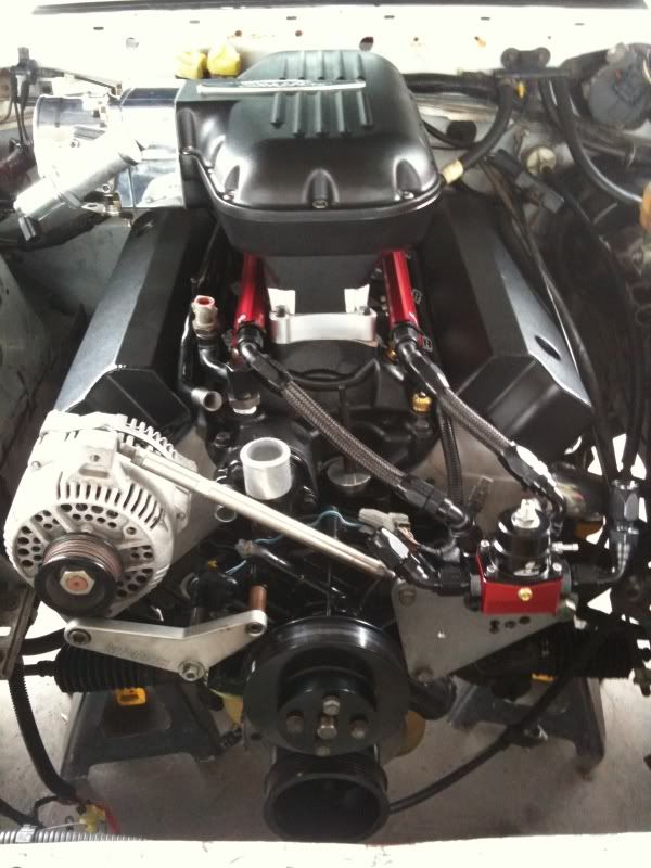

Getting closer.....
GLDNPNY
Well I still have alot do do but I have done alot. I hate only being able to work on it during the weekend!!!!

Wow. Do you have a build thread somewhere? I don't know what all is inside that beast.
Its a Boss Block
4.125" bore
3.4" stroker crank
5.4" rods
custom forged pistons
363 cu inches
Canton Pan
DSS Stud girdle (on a splayed 4 bolt main block I know its a little overkill but they threw it in for free since I am military)
AFR 185 heads
AFM N-61 HR cam
BBK 1 3/4" longtubes
Trick Flow Box "R" intake
Mallory Billet TFI distributor
36lb Trick Flow injectors
80mm Accufab TB
97 mm DBX meter
AFM 4" Power Pipe
AFM "40" plug wires (AFM's version of the Moroso Super 40 except they are black. They look so cool I actually got aroused when I opened the box!)
McLeod RST dual disk clutch
Fidanza billet aluminum flywheel
Lakewook scattershield
G-Force 26 spline T-5
Aeromotive Eliminator Stealth fuel system
AFM PMS for tuning
Basically I said "Screw It" and got everything top notch. Hell you only turn 40 once right?
