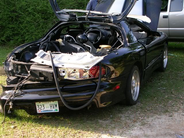

it didnt get that hot. Not hot to touch. Just heated up to fast and blew off. Just gotta replace the washer in there. And that guy used jb weld to close up the blow off valve and caused the bottle to explode.

That's what they have bottle wrmers for man, I would never put on open flame next to something like that man.
It got hot enough to push out a 3000 PSI burst disc. Has nothing to do with how quick it got hot.
But I've said what I needed to say, and I'll leave it alone. People torch bottles every day, and the hammer usually falls on an empty cylinder when they do, so it's hard to convince them to stop pulling the trigger.
Xodus989
Every time you heat up your bottle with a torch you're ****ing with the integrity of your bottle... You're lucky nobody got hurt. Seriously, just buy a bottle warmer. It's only what, 80 bucks?
