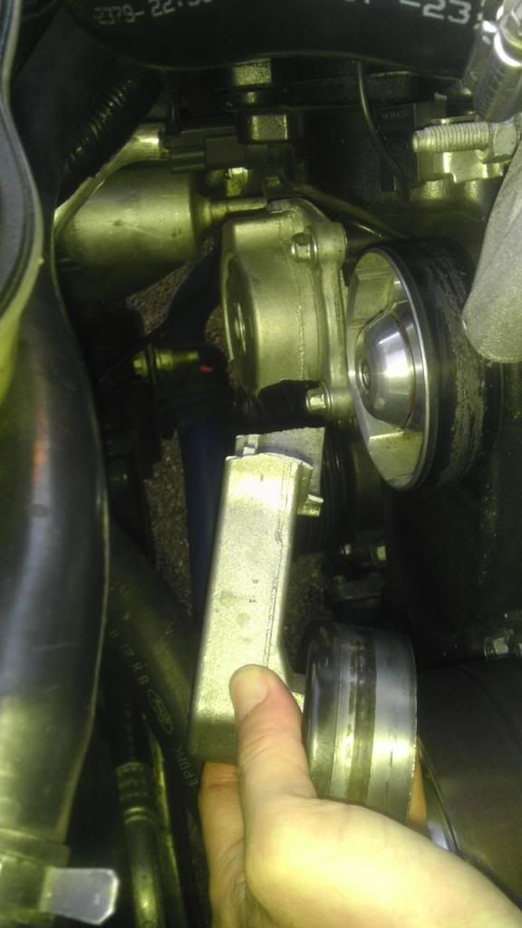

i keep on forgetting how positive displacement blowers love cold air, 42-45 degree night plus 18#s of boost with no warming up the car feels like a kick in the chest and getting thrown back in the seat like a ragdoll. it was fun while it lasted but unfortunately my tensioner took the burnt of it...how does that happen??? this was followed by a 12 hour stay at the side of the road while it took triple a 3 tries to be able to find a truck that could tow me :(
