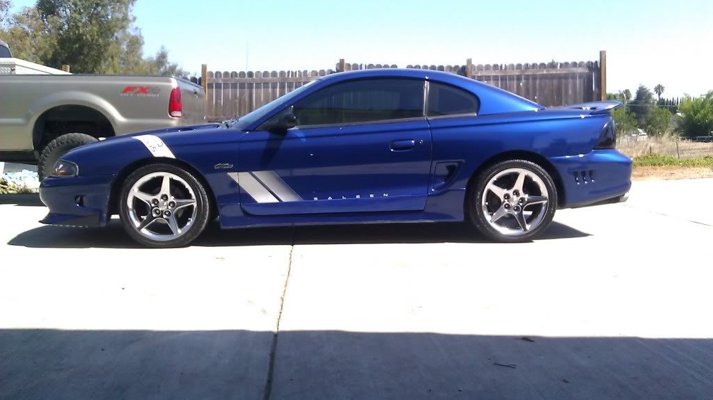

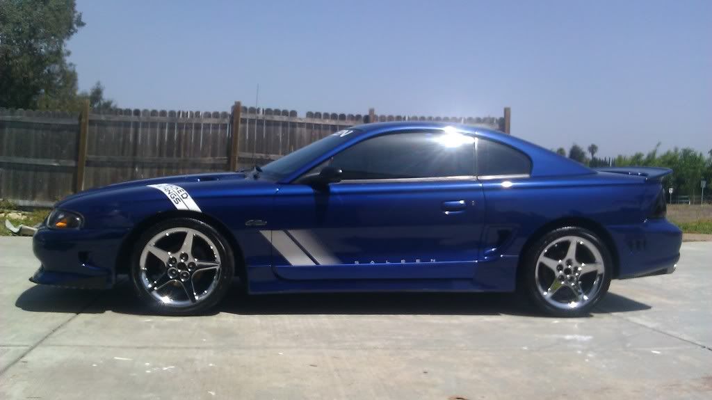

alright sorry it took a couple days to get back but I needed time to take pics...I ended up cutting the front springs and am VERY happy with the results. If you were looking at the spring from a side angle I cut off a piece 3" long, and if you were looking at the drop (using a level) from where it was to where it would be it was a 3/8" drop...this translated to a grand total of a 3/4" drop and took about two full days to fully have the springs "drop" or "set" (not quite sure the propper term) the car's ride quality did not change no worse, no better, bumpsteer is the same as was, BUT something else did change :) handling got BETTER, I was skepitical and was thinking it was placebo effect but there are a couple roads that I drive frequently and take my car to to test things out, and had two different people that have been on my little test runs with me and no joke handling SIGNIFICANTLY improved! Made me damn happy, and the drop looks wise is exactly what I needed/wanted for my current set up! Now of course the ONLY reason it turned out as good as it did and did not realy effect ride quality was the face that I have awesome struts and the fact that I had linear springs, wouldn't have worked even a little bit without them
Before...
After
Its kinda hard to see it but its there...3/4" of a drop.

Can definitely see the rake difference. Looks good/better! Really like that color blue.....CLEAN!!
